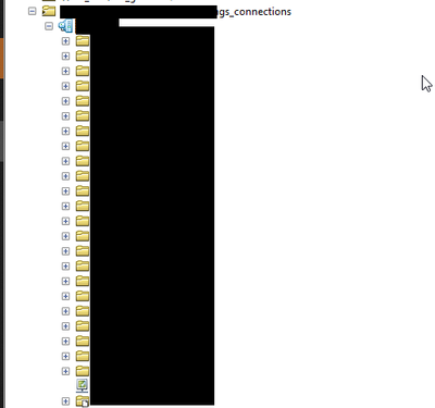

3. It looks like the issue is with the server connection parameter (If I am reading the French right?). I would test my server connection with ArcCatalog. You should be able to navigate to it and open it with ArcCatalog.

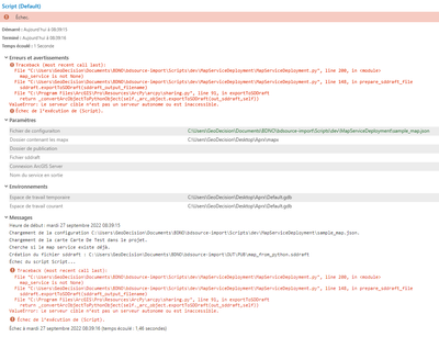

Thanks for your reply, I just found that is an error when ags con is allready open.
Yes it's a french arcgis pro.
When I launch the script first time when arcgis pro open, it ask me for trust certificate and deploy mapservice, when I launch it again (or after click on ags connexion to view it's content), I have the error.
sharing.py", line 91, in exportToSDDraft
return _convertArcObjectToPythonObject(self._arc_object.exportToSDDraft(out_sddraft,self))
ValueError: Target server is not a standalone server or is inaccessible.
Thanks for your time.
Guillaume

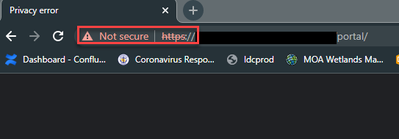

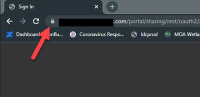

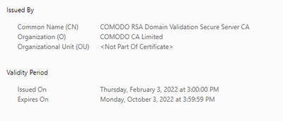

hmmm.... normally ArcMap only asks me to trust the certificate if there is an issue with it. I wonder if you are using a self signed certificate or maybe one that has expired. You can check your certificate in chrome.
Click on the little lock thing to get the info:
This is one of mine:
Or you may see something like this:
Of course you need to check the one on the ArcGIS Server, not the Portal one.

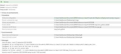

It's a dev server so certificate is auto sign so not secure.
I want to publish it from arcgis pro.
As I say before, it work first time :
But not when i relaunch it :
If i restart arcgis pro, i can run script 1 time without craches

Yes, I think it is your self-signed certificate. My guess is the first time is asks you and runs fine. The next time it does not ask (for whatever reason) and fails. We used put self signed certificates on our dev and test machines, but now we put "real" ones on all of our servers. Situations like this was one of the motivating factors. Can you put a singed certificate on the server?
