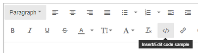

It would help if you used the code formatter (click the ..., then the </> icon to open the window to paste your code)

It's very hard to read your script in plain text. Please post it formatted as code:

Thanks Johannes for the tip. I had no idea.
