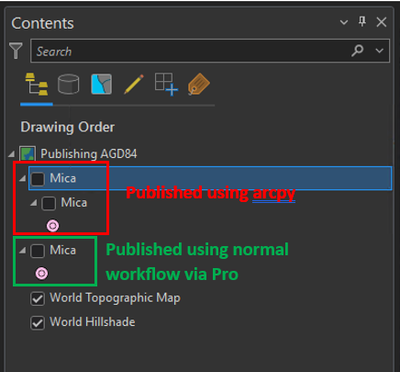

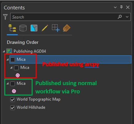

Is it possible to publish a single layer programmatically so that it is not nested in it's Feature Service. When I publish a layer using the below script and I add the resulting Feature Service to Pro from Portal, it adds as a nested layer - My Layer\My Layer - but if you publish a Layer using the normal workflow from Pro by right clicking the Layer in the contents pane and selecting Sharing > Share As Web Layer, adding it to the project will only add the inner layer, not the nested layer.
Not sure if that makes sense but can try explain more clearly if required. Following screenshots might help to clarify as well.
