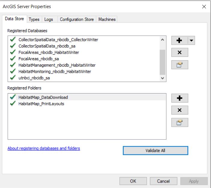

Next, I validated all my connections:
I have tried to see if changing the names of the connections listed in the Data Store to match that of the new paths in the script makes it publishable, but no luck (e.g. FocalAreas_nbcidb_HabitatWriter  gets changed to the new name which is FocalAreas_HabitatWriter).
