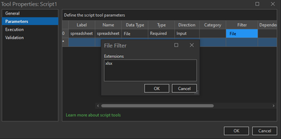

I am having this problem when running script tool on ArcGIS Pro. The full path is to be defined via the tool with parameter setting as below.
And the code for the script tool is simple as below.
