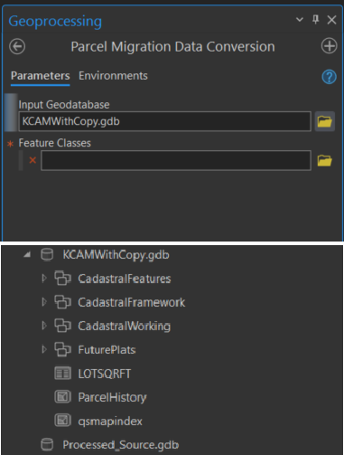

Current script toolbox and geodatbase
Thanks in advance!

I think you need to define parameter B as GPValueTable and populate the ValueList filter with a list of feature class names.
Defining parameters in a Python toolbox—ArcGIS Pro | Documentation
StaticK
MVP Alum
You have your gdb set to the feature dataset parameter in the List Featureclass which I think will return in an empty list.  You need to iterate through the gdb, by setting the arcpy.env.workspace to the gdb and use ListDatasets() with ListFeatureClasses to get them:
arcpy.env.workspace = gdb
if self.params[0].altered:
    _tmparray = []
    for ds in [ds for ds in arcpy.ListDatasets(feature_type='feature') if ds is not None and ds != '']:
            for fc in [fc for fc in arcpy.ListFeatureClasses(feature_dataset=ds) if fc not in fcExclude]:
                    # append featureclass string to the fc list
                    _tmparray.append(fc)
    fcFilter = self.params[1].filter
    fcFilter.list = _tmparray
 Adding the .altered flag to that param will execute the list filter each time a new gdb is selected.
