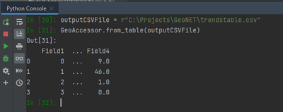

FredMitchell
Hi Jake,
Thanks for looking into this for me and adding these key pieces of code. When I run line 66 I get the following error:
KeyError                                  Traceback (most recent call last)
In  [50]:
Line 1:     adds_fs = csvDF.spatial.to_featureset()
File C:\Program Files\ArcGIS\Pro\bin\Python\envs\arcgispro-py3\lib\site-packages\arcgis\features\geo\_accessor.py, in to_featureset:
Line 3573:  return FeatureSet.from_dict(self.__feature_set__)
File C:\Program Files\ArcGIS\Pro\bin\Python\envs\arcgispro-py3\lib\site-packages\arcgis\features\geo\_accessor.py, in __feature_set__:
Line 3297:  if self.sr is None:
File C:\Program Files\ArcGIS\Pro\bin\Python\envs\arcgispro-py3\lib\site-packages\arcgis\features\geo\_accessor.py, in sr:
Line 3503:  for g in self._data[self.name]
File C:\Program Files\ArcGIS\Pro\bin\Python\envs\arcgispro-py3\lib\site-packages\pandas\core\frame.py, in __getitem__:
Line 3505:  indexer = self.columns.get_loc(key)
File C:\Program Files\ArcGIS\Pro\bin\Python\envs\arcgispro-py3\lib\site-packages\pandas\core\indexes\base.py, in get_loc:
Line 3631:  raise KeyError(key) from err
KeyError: None
Any thoughts?
JakeSkinner
Esri Esteemed Contributor
Can you share the CSV you're using to one of the AGOL groups you invited me to?
FredMitchell
It's shared!
JakeSkinner
It's something with how the CSV is being created.  When trying to read the CSV file, it is not being read correctly.  See below:
I'm not sure if it has to do with the delimiter being used or something else, but this is where you will need to troubleshoot further.   Sorry, I'm not an expert with dataframes, so not sure how much help I will be.
