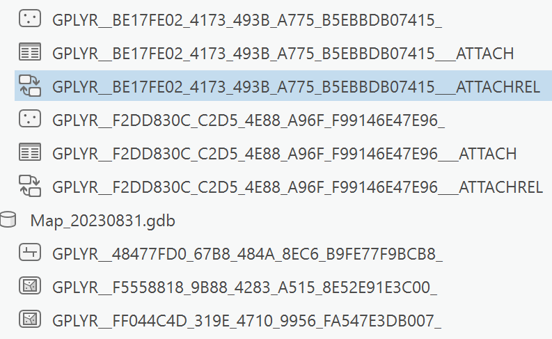

Hello,
So I'm working on a python script to back up hosted feature layers in AGO to a local file geodatabase.
I'm aware of this one on ESRI's knowledge-base, https://support.esri.com/en-us/knowledge-base/how-to-back-up-hosted-content-by-looping-through-and-d... but it's a little more broad than I'm really looking for. And I'm trying to develop something that's friendly for people who aren't as familiar with python (or scripting in general). Idea being that someone can just add a layer to the map and it'll get included in the back up and you don't have to worry about getting tags, categories, or ownership stuff set up. Best practice aside, that's that reality.
Here's the script I'm running and it works but I sometimes get an odd output for the feature class names like "GPLYR - [GlobalID looking string]" (see snip below the code).

I've also written another version of the script that loops through all the maps in the Pro Project to copy the hosted feature layers to file geodatabase (one per map). Usually one of the back up sets of hosted feature layers has the correct names but the others have that GPLYR name for the feature class.

Maybe FeatureClasstoGeodatabase isn't the best method? I'm trying to use ExportFeatures, but for whatever reason I cannot get it to work. It looks like there are some parameters from FeatureClasstoFeatureClass that didn't get carried over to ExportFeatures when it get deprecated.
Thank you for any help or input on improving the script methodology or why some feature classes are getting named GPLYR and how to solve it.
