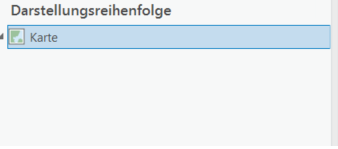

So initially, my map and the table of contents are empty:

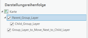

Then, my script adds C (or parent_group_layer)  (line 10). Afterwards, B (or child_group_layer)  is added (line 14) and moved below C (line 17-18). In the next step, A (or group_layer_to_move_next_to_child_layer) is added to the map (line 21).
The table of contents now looks as follows:

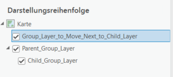

Finally, I want to move A next to B (line 24). However, A is not placed as child of C and on the same hierarchy level as B, but on the same hierarchy level as C:

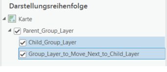

My intended result would look as follows:
