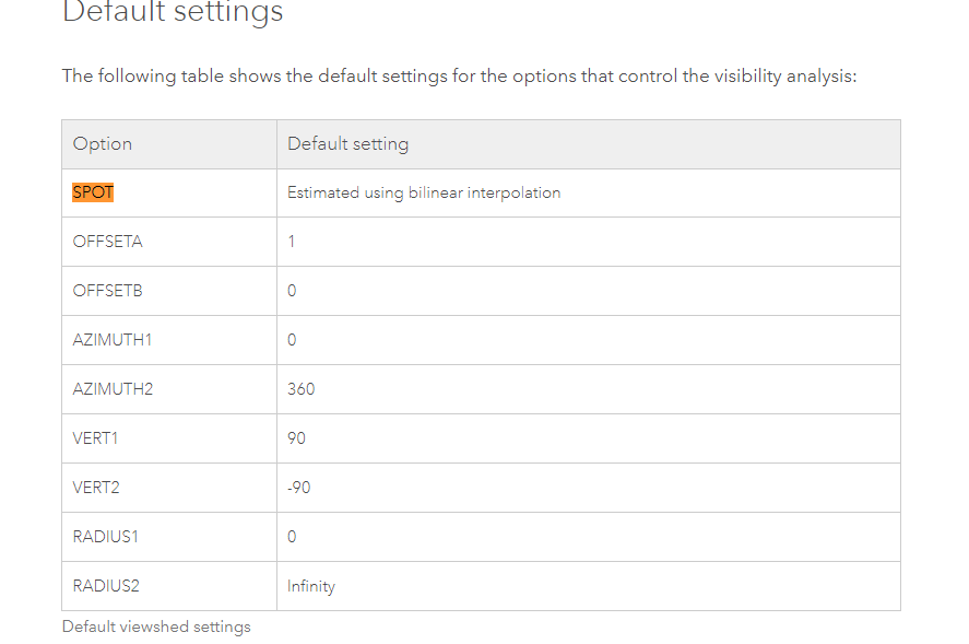

H! I was looking at the ESRI documentation for the Observer Points 3d function:
https://pro.arcgis.com/en/pro-app/latest/tool-reference/3d-analyst/observer-points.htm
I found that these below are the default settings for Visibility Analysis for this function, as well as the Viewshed function:
How do I use the python function to change these default settings? The only parameters I can find for the Observer Points 3d that can be altered are the z-factor, curvature correction, and refractivity coefficient. I even used the calculate field functions to change the attribute table of the input feature class, but it did not change the default settings of the function.

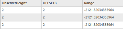

This is what the attribute table looks like for the output. Range and ObserverHgt are aliases for RADIUS2 and OFFSET A, respectively.
However, no matter what value I change these options to, it always returns the same viewshed, as if the values in the attribute table did not affect the output of the function ObserverPoints at all.
DavidPike
MVP Notable Contributor
you have negative values for RADIUS2?  I don't understand.  Aside from that it might be worth changing your aliases to radius2 etc.  I have a distant memory of having something similar before.
