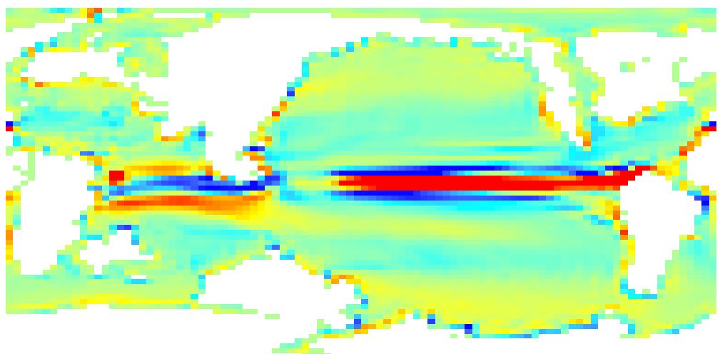

I'm trying to use python to shift the longitude values of a netcdf file. The original file longitude goes from -1.875 to +360
I need the file to show properly when importing it in Arcmap (Make NetCDF Raster Layer) so the raster and its values are -180 180 (as well as -90 90). The values are vertical velocity depth.
I'm trying a short script that someone showed online with a similar issue. Apparently it worked for him. In my case I just manage to shift the frame but not the values (see picture).
Any suggestions? Many thanks
