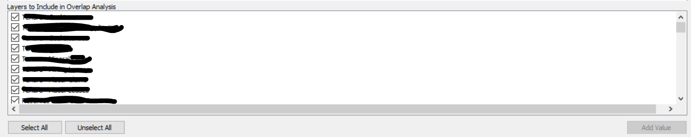

The parameter in the old tool looks like this:
Where the user can toggle on or off, which items from the list they want by either selecting or deselecting the check boxes or utilize the 'Select All/Unselect All' buttons.

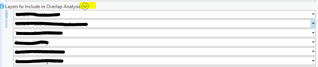

In ArcGIS Pro, the parameter behaves a little differently. First, the appearance has changed:

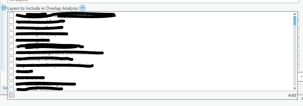

In the above image, the list is populated based on the same validator logic above, but does not have the check marks beside it (let's call this the main list). In order for the user to get the option to check off items from the list, they have to click on the dropdown button (highlighted yellow in the image above) which will pop out a submenu with the same list (lets call this the sub list) except here, the user can then check off the items they want.
