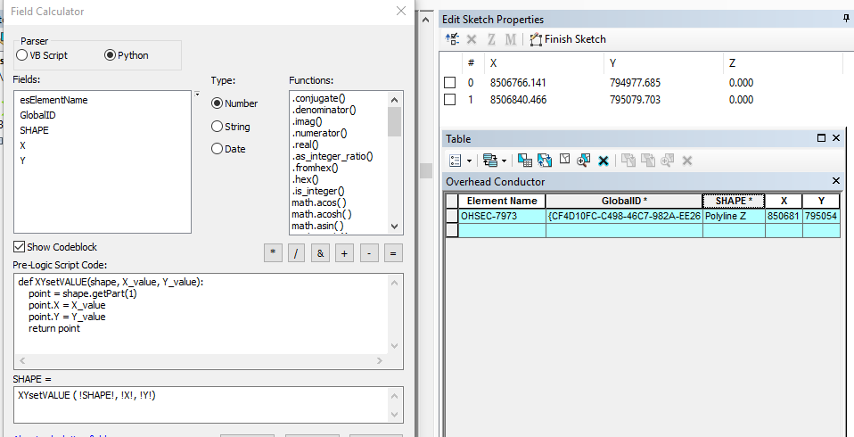

How do I go about moving the endpoint of a polyline using field calculator? I have the x,y end point coordinates in the "X" and "Y" fields.
def XYsetVALUE(shape, X_value, Y_value):
point = shape.getPart(1)
point.X = X_value
point.Y = Y_value
return point
SHAPE = XYsetVALUE ( !SHAPE!, !X!, !Y!)

6 Replies
XanderBakker
Esri Esteemed Contributor
The point is that you can read the lastPoint from a Polyline, however, it is read only, so you can't set the new value. To do this you would have to loop over the points that construct the polyline and replace the last item. It is also important that you return a valid polyline that will be written to the featureclass.
I also notice that you have the Z value enabled of your polyline geometry. This will make it a little more complicated, but I guess that you could do this with the following snippet (if the line is not a multi part):

AdelaideZumwalt1
Hi Xander,
The vast majority of my lines are not multipart, which is good. When I run it using a NULL z value the line disappears. When I set a z value it gives me the following error:
Codeblock:

JoshuaBixby
MVP Esteemed Contributor
I typically use Update Cursors for such activities, I can't recall whether Field Calculator even let's someone update the geometry field.
You are calling getPart(1), are these multi-part lines?
AdelaideZumwalt1
No, they are not multipart. I used this blog to update point locations using field calculator successfully:
https://community.esri.com/groups/technical-support/blog/2011/12/06/how-to-update-the-location-of-a-...
