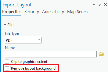

I tinkered with the Python parameters, as well as the settings within ArcGIS Pro and have narrowed the issue down to the "keep_layout_background" parameter. I get borders around my layout elements when specifying a value of True for this parameter, and I do not when specifying a value of False.
However, I noticed that while the exportToPDF documentation shows this parameter in Python as "keep_layout_background", in ArcGIS Pro, this parameter is named "Remove layout background". The wording of these parameters read in an opposite fashion, however, they seem to behave the same. Specifying a value of True in both Python and ArcGIS Pro produces the border issue in my exported PDFs, while a value of False does not.
I must assume this inconsistent wording is an oversight, and that they should be the same/similar? I also can't explain why this border issue only occurs for a map series layout.
