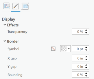

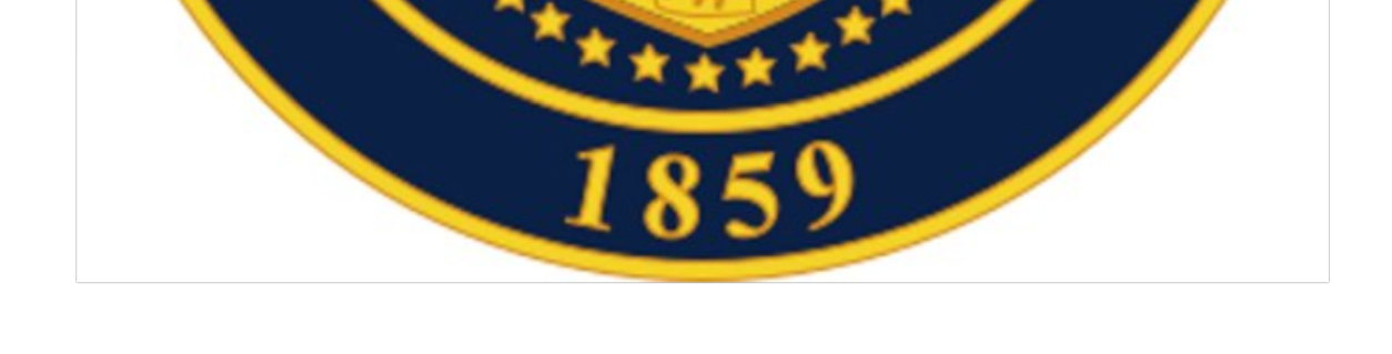

In Pro 2.9.0 I have a picture element that is displaying a .jpg file. When I look at the element in the layout in Pro I see no border around the element. This is confirmed when checking the border properties.
However when I export the layout to a pdf there is consistently a border around the image.
I've played around with the export settings and the picture element settings and can't seem to find what is causing the issue.  Anyone have any thoughts?

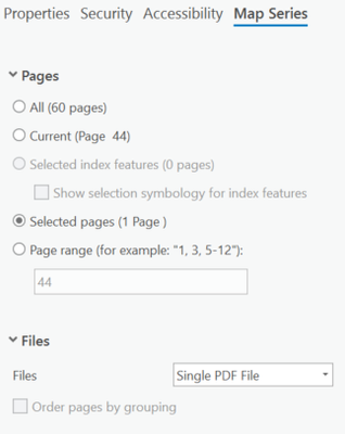

Thanks @AubriOtis! I checked by opening in a browser as you suggested and was still seeing the issue.
After some additional testing I realized it is only occurring when I have a map series and the Files setting set to 'Single PDF File'. I switched it to multiple pdf files which resolved the issue.
