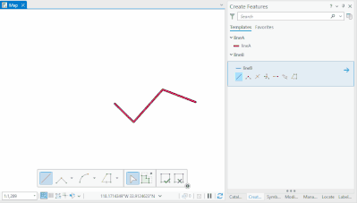

Along with @CarlMorrison said, you may also consider using the Trace tool to trace along another line for a specified distance.
GIF:
