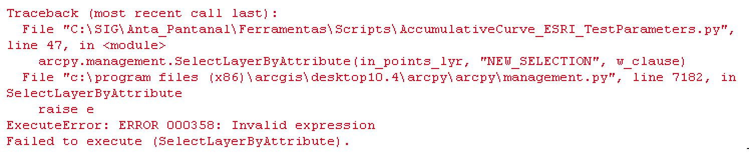

That's the error message!!!
Why that error???

Hmmm, strange. A few things I can think of:
Make sure that in_points actually has the sort_field. For example shapefiles usually don't have OBJECTID.
Try to modify the expression to w_clause = '%s < %s' % (sort_field, i + 1)
I hope you'll find where the problem is.
F.

Shapefiles use FID and begin at 0... geodatabase is OBJECTID (do they begin at 1? can't remember)

Rather than hard-coding the name of the OID/FID (sort_field = 'OBJECTID'), you can get it dynamically by describing the data:
sort_field = arcpy.Describe(in_points).OIDFieldName

Hi Filip.
Such a great job!!!
Thanks so much!!! 100000x tks.
Regards
