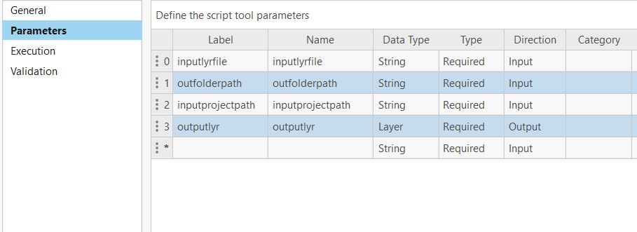

Following are input/output parameters set in Tool properties

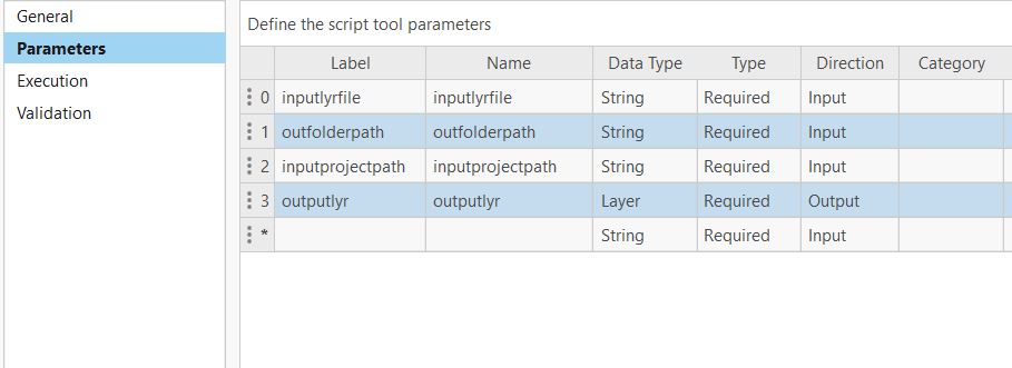

Following are input/output parmeters set in Tool properties
