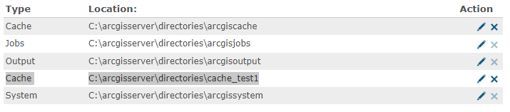

I am trying to replicate the workflow of publishing a WMTS service that has cache from ArcGISPro with python (outside of ArcGIS pro environment / standalone script). The issue is that I have pre-calculated cache available for my service and would like to include it programmatically. The precalculated cache folder name starts with the server folder followed by the map service name as such: {folder}_{map service name}. I've added the precalculated cache to a server folder that i've linked in the manager site tab as type: Cache (see image below).
