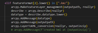

Has anyone had luck with this since the original post?  I'm experiencing the exact same issue, using Pro 2.9.5 and a colleague is seeing the same thing with Pro 3.
Trying to add the Layer to KML tool into a custom GP tool (modifying the Data Extract script tool to add KML and JSON export options) and the script will run successfully and create a zipped folder, but the tool doesn't run, the zipped folder is empty, and it throws a warning saying that I need the Data Interoperability extension.

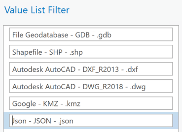

jfischer91
We were able to remedy this by changing the configuration in the pick list of the format type parameters.  I had the quotes set up wrong; things are working now that they are set up as below:
