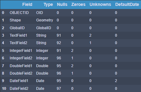

JohannesLindner_0-1689266678674.pngJohannesLindner_0-1689266678674.pngJohannesLindner_1-1689266693900.pngJohannesLindner_1-1689266693900.png
SearchCursor reads values from date fields as datetime.datetime objects, so you can compare to that.
import arcpy
import datetime
import pandas as pd
def analyze(in_table):
    fields = arcpy.ListFields(in_table)
    result = [
        {"Field": f.name, "Type": f.type, "Nulls": 0, "Zeroes": 0, "Unknowns": 0, "DefaultDate": 0}
        for f in fields
    with arcpy.da.SearchCursor(in_table, [f.name for f in fields]) as cursor:
        for row in cursor:
            for i, val in enumerate(row):
                if val is None:
                    result[i]["Nulls"] += 1
                elif val == 0:
                    result[i]["Zeroes"] += 1
                elif val == "unknown":
                    result[i]["Unknowns"] += 1
                elif result[i]["Type"] == "Date" and val <= datetime.datetime(1950, 12, 29):
                    result[i]["DefaultDate"] += 1
    df = pd.DataFrame(result)
    return df
display(analyze("G:/ArcGIS/data/Arcade_Test_Data.gdb/TestPoints"))

ZainAhmad
Thank you Johannes. It worked.
