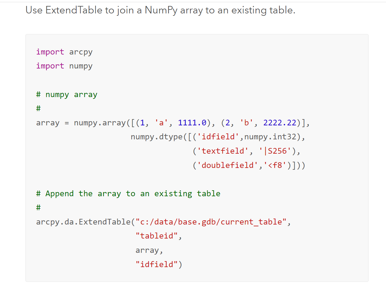

ESRI Example:

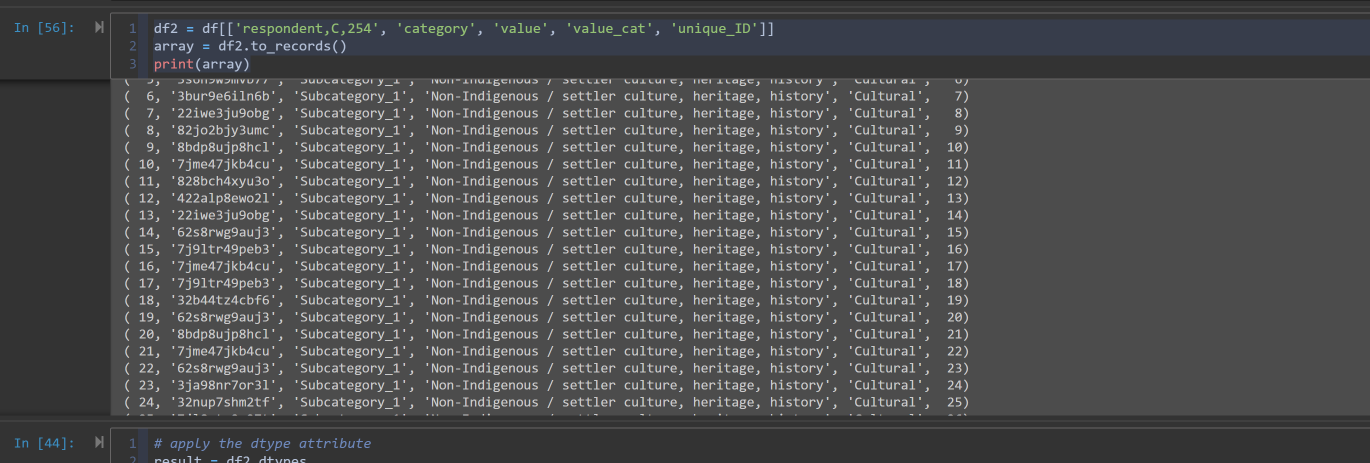

This is my code
# df = the csv of survey data
df2 = df[['respondent,C,254', 'category', 'value', 'value_cat', 'unique_ID']]
array = df2.to_records()
print(array)

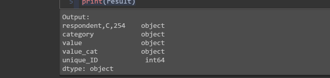

# apply the dtype attribute
result = df2.dtypes
print("Output:")
print(result)

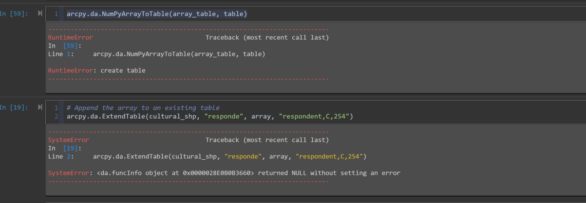

These are my errors - have I not formatted my array correctly?

ExtendTable (in_table, table_match_field, in_array, array_match_field, {append_only})
 Which would be
arcpy.da.ExtendTable(cultural_shp, "responde", array, "respondent")
If the field names are correct and the featureclass name reference is correct.

Still getting an error - have I not called the correct fieldname in the array? Or is it some sort of type error for the fieldname? The fieldname I am looking to join to the shapefile is called "respondent,C,254" (name has been copied from the original csv).
Code attached and errors + outputs below in the screenshot

The warning is just that, you don't use numpy.object any more 'O' or object will suffice.
Your field names are horrible, but workable, BUT they won't be able to be used in extendtable because there is punctuation in them.  Check the actual data, it should be a list of tuples
