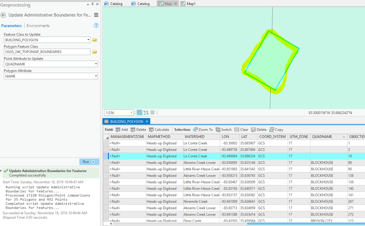

Here is something interesting: when I try to extend the point-in-polygon script to polygon-centroid-in-polygon (what administrative boundary is this building located in?), if the input polygon intersects the within polygon (building straddles a county boundary), the result is null:

Here's the full snippet (which I've attached to a toolbox). Even using SHAPE@ I still get the nulls for polygons that straddle a polygon boundary. Have also tried  SHAPE@ and SHAPE@TRUECENTROID

DanPatterson_Retired
MVP Emeritus
How do they straddle a boundary? is that determined via polygon to polygon intersection? (ie polygon intersects polygon …. not polygon within polygon)
If you are comparing the centroid of a straddling polygon, the centroid may not be within the bounds of the intersecting polygon
