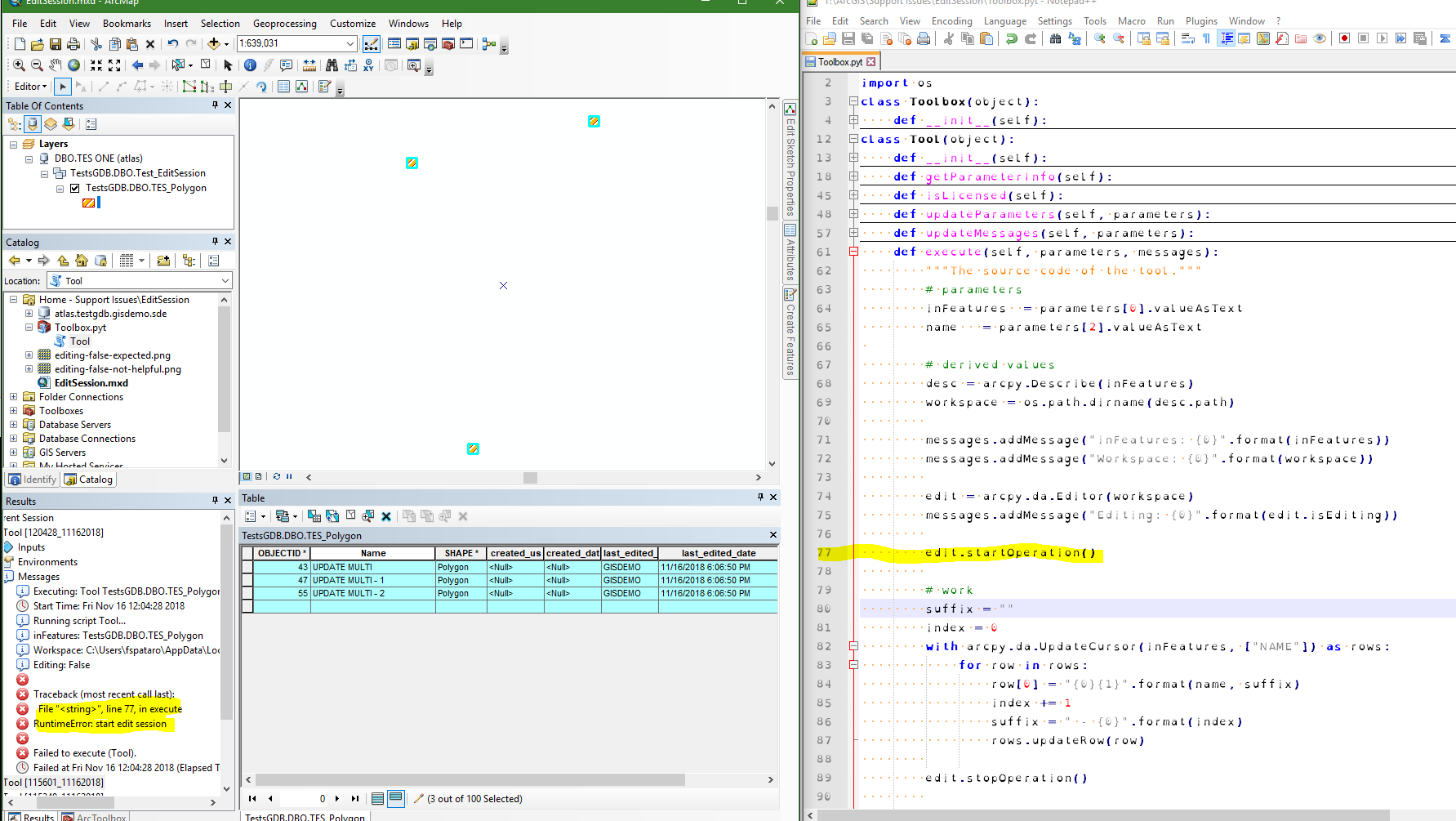

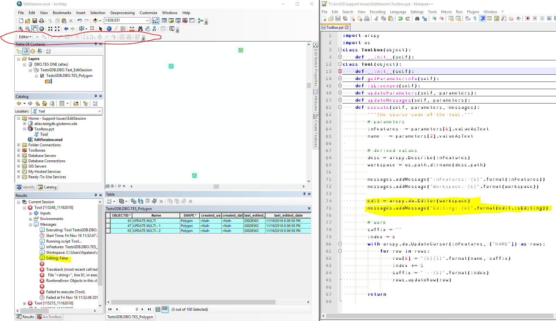

  • If 'ArcMap edit session' is closed, tools fails as expected:
       "Objects in this class cannot be updated outside an edit session [TestsGDB.DBO.TES_Polygon]"

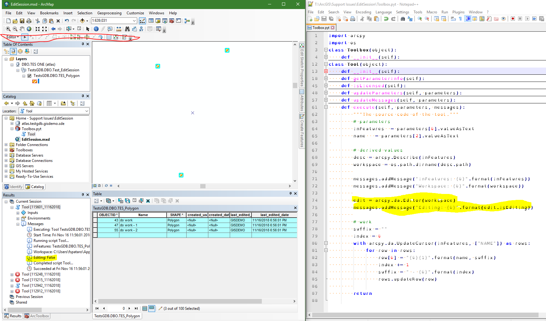

  • Added arcpy.da.Editor to check if 'isEditing':
    • returns false regardless of the ArcMap editor state --- makes sense that it's not the same session
  • Added editor.startOperation() and editor.stopOperation() with the ArcMap edit session open
    • fails with "start an edit session"

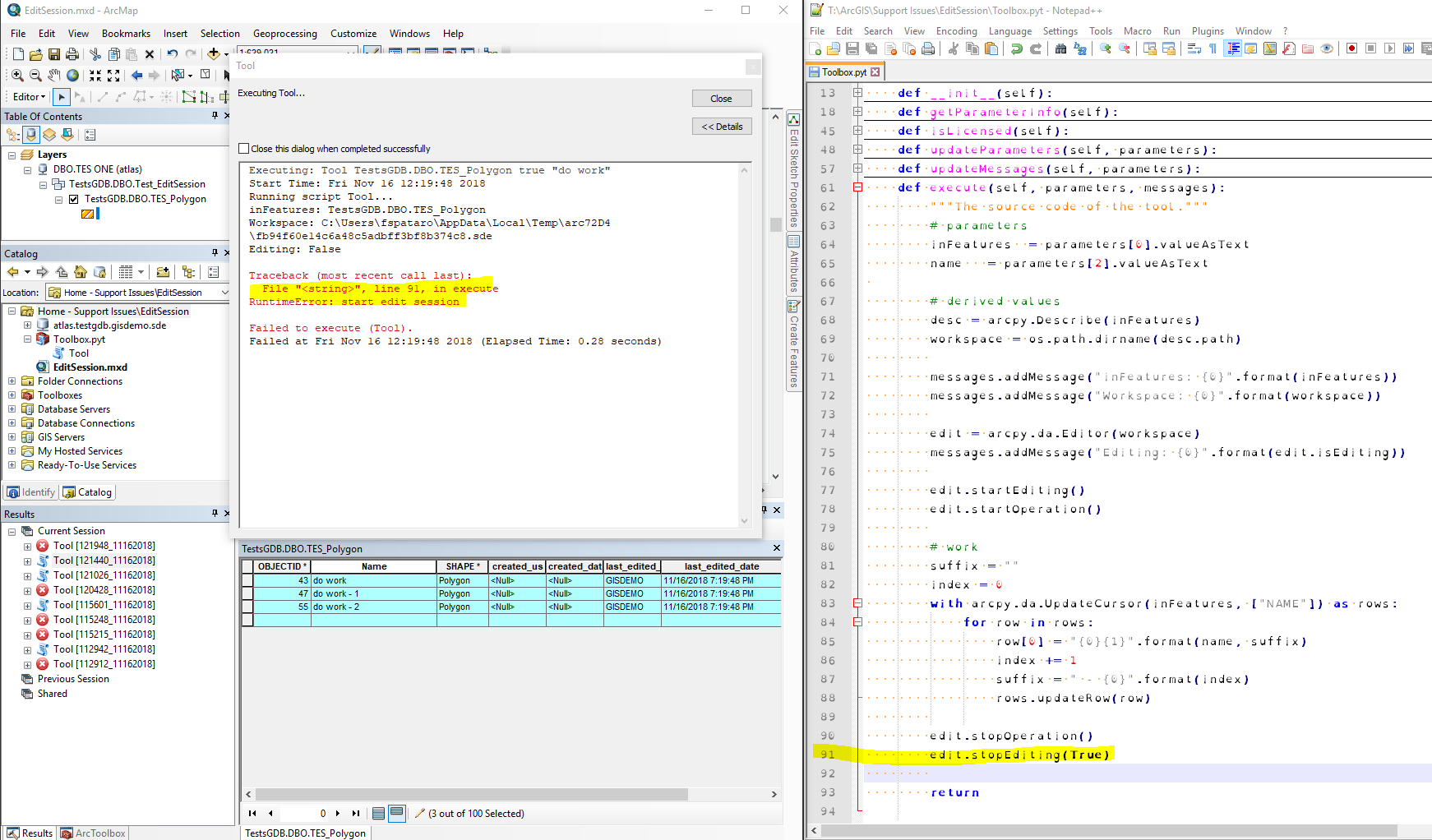

  • Adding editor.stopEditing() with the arcmap session open
    • this throws an error on the editor.stopEditing() with the message - "start edit session"
    • this result baffles me ????
    • the attribute edits are correctly placed and the "save edits" dialog prompts when clicking 'stop editing'. So it's almost correct behavior except for the "tool failed result"
