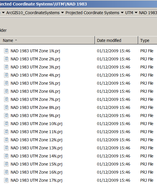

NeilAyres
MVP Alum
Kept a copy of the old *.prj file structure before it disappeared.
That doesn't look like 2 spaces in that name...
