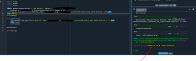

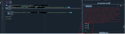

For example the code in the first image works because the "conn.close()" is commented out.  The second image shows the results of the same code with "conn.close" included and the function call fails:
