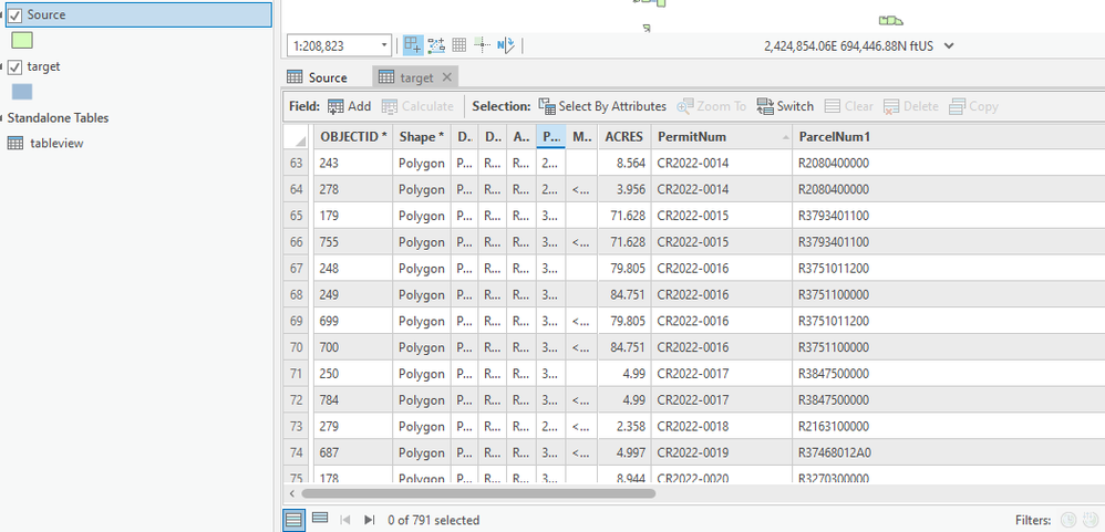

    This causes row[0] to be None, rather than a polygon object, making the two tables mismatch.AlfredBaldenweck_2-1680545748028.pngAlfredBaldenweck_2-1680545748028.png

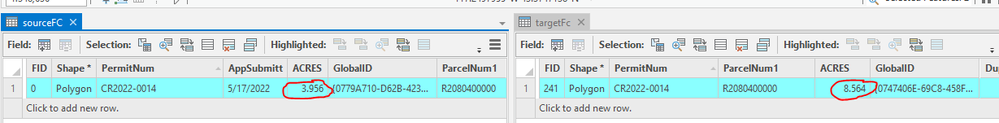

  • You have some mismatched acreages between the two tables (There are 35 of these where their shapes are the same.)AlfredBaldenweck_1-1680545677862.pngAlfredBaldenweck_1-1680545677862.png

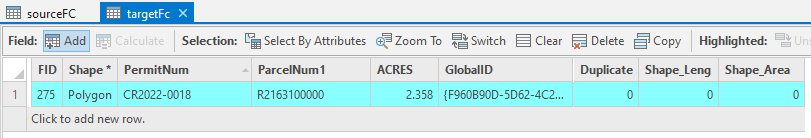

Oh wow. I looked back at my original data and there no empty geometry. I think I might have shared one (targetFC),that must have corrupted after testing, my apologies.
I have attached a copy of the original data(targetFC), with the unnecessary fields removed. I verified there were no empty geometry, again my apologies.

CCWeedcontrol
I was able to solve the empty geometry, by adding ['Shape@'] in the field names. I also included the sql_clause you had.
Based on I am seeing and the print out, the script is just adding all the features from sourcFC and not acutally comparing and inserting the missing ones.
