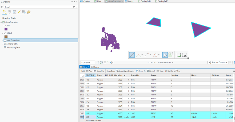

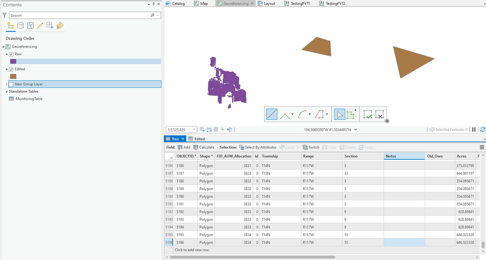

I have a my raw (target) table, which is purple and has 5196 records.AlfredBaldenweck_1-1680195677972.pngAlfredBaldenweck_1-1680195677972.png

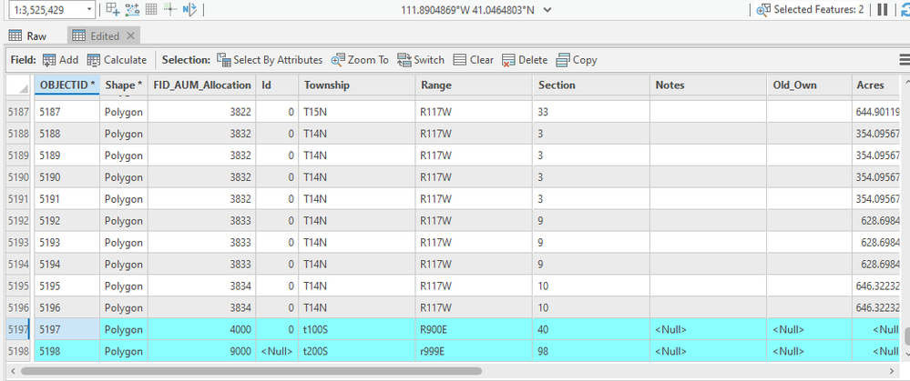

My edited table (fc1) is brown and has 5198 records. (I don't have these two records selected when I run the code)

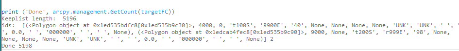

Running the code:
aprx = arcpy.mp.ArcGISProject("CURRENT")
mp = aprx.activeMap
fc1 = mp.listLayers("Edited")[0] # Copy in the Edit GDB, contains 25096 records
targetFC = mp.listLayers("Raw")[0] #Copy in the Published GDB, contains 11396 records
dsc = arcpy.Describe(targetFC)
fields = dsc.fields
out_fields = [dsc.OIDFieldName, dsc.lengthFieldName, dsc.areaFieldName, 'Field1','Field2', 'Field3']
fieldnames = [field.name if field.name != 'Shape' else 'SHAPE@' for field in fields if field.name not in out_fields]
#print(out_fields)
#print(fieldnames)
keepList = []
# Switched from fc1 to targetFC
# You want to check the final product first
with arcpy.da.SearchCursor(targetFC, fieldnames) as cursor:
    for row in cursor:
        keepList.append(row) #Appended row, not row[0].
                             #Otherwise they might not check for the same thing
print("Keeplist length: ", len(keepList))
del cursor
#list of values from fc1 to inject into targetFC
ids = []
#Check for missing values comparing by row in total.
with arcpy.da.SearchCursor(fc1, fieldnames) as cursor:
    for row in cursor:
        if row not in keepList:
            ids.append(row)
print("ids: ", ids, len(ids))
del cursor
#import all fields
#create insert cursor variable
with arcpy.da.InsertCursor(targetFC,fieldnames) as insCursor:
    for rows in ids:
        insCursor.insertRow(rows)
print ('Done', arcpy.management.GetCount(targetFC))
My two new records are added to the target (ignore the OBJECTIDs; I've run this a few times already).

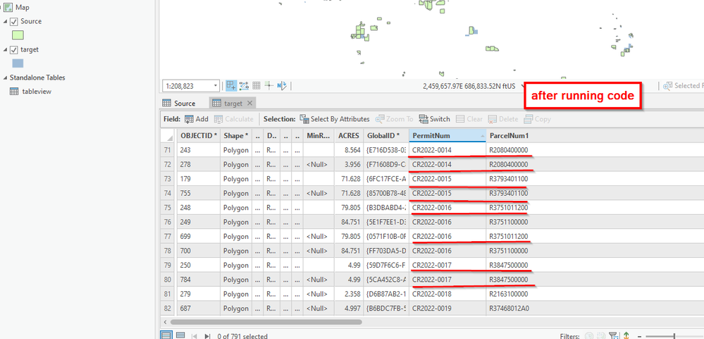

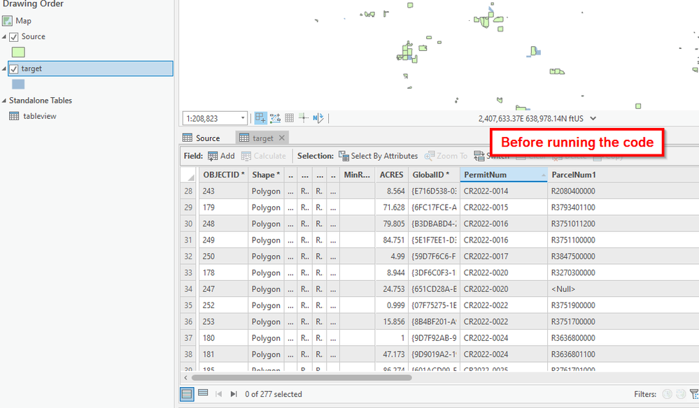

CCWeedcontrol
I was running this outside Pro and thought maybe that was why I was getting different results but no. I put the info in Pro and ran the code.
Here are my resultsBeforeRunningCode- ArcGIS Pro.pngBeforeRunningCode- ArcGIS Pro.pngAfterRunningCode- ArcGIS Pro.pngAfterRunningCode- ArcGIS Pro.png
I thought maybe I had something wrong in the code, so I copied the code you posted and ran it.
