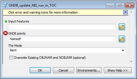

TimothyHales
Esri Notable Contributor
Martin,
I created a new pyt with the code provided, and the parameter shows optional for me:
Have you refreshed the toolbox since you updated the code? Could you try copying it into a new pyt?
Timothy

TimothyHales
Martin,
Timothy
MartinHvidberg
Thanks for your reply.
I restarted ArcMap, and now everything works exactely as expected 🙂 ???
/ Martin
MartinHvidberg
for the record: I had used 'refresh toolbox' many times during the edits, so that was not the problem.
