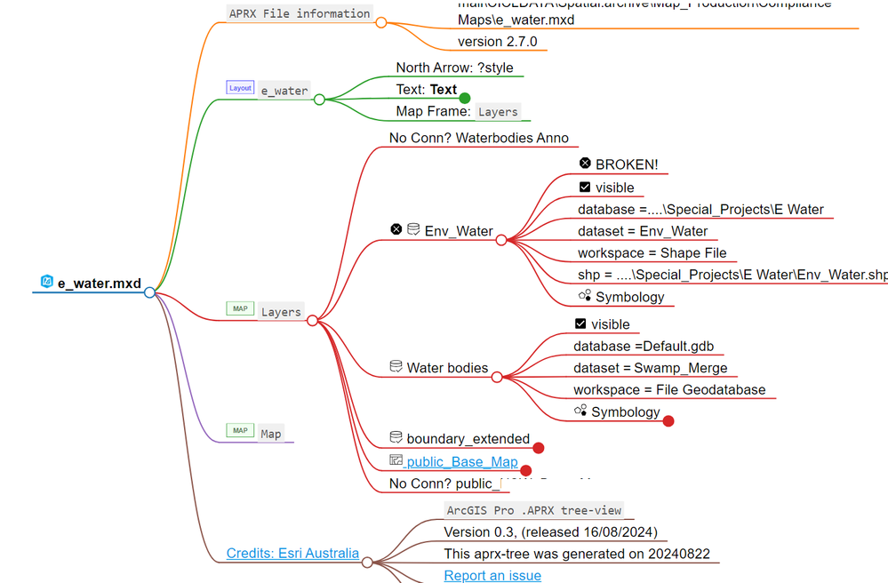

I am working on an APRX-Tree-Viewer,  but importing .mxd sometimes blocks (no error, no time-out, just stuck forever)
