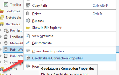

RhettZufelt
MVP Notable Contributor
You can configure what 'version' the SDE connection file is connected to.
In Catalog pane, right click the database and choose Geodatabase Connection Properties.  In that dialog box, you can select which version that particular connection file references.
