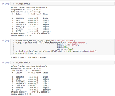

Furthermore: from_feather only returns a pandas dataframe. To recunstruct a SEDF one needs to use
sdf = pd.DataFrame.spatial.from_df(df, sr=25832, geometry_column='SHAPE')
