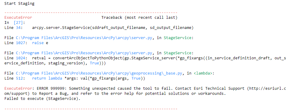

I'm trying to publish a feature class and following this procedure: https://pro.arcgis.com/en/pro-app/3.3/arcpy/sharing/featuresharingdraft-class.htm
but is giving the error:
I have checked this post: https://community.esri.com/t5/python-questions/publishing-feature-class-returns-error/m-p/1477664#M7...
But for me his solution didn't work.
here is my code:

JakeSkinner
Esri Esteemed Contributor
@JV_ if you Analyze the map by publishing it manually, are there any errors reported?
JV_
@JakeSkinner No, it was published okay. I tried checking the history to see if the 'Copy to Python' command was available when sharing, but it does not exist. 😓
JakeSkinner
@JV_ I would test with another Pro Project, and also another ArcGIS Pro client machine.
