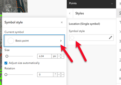

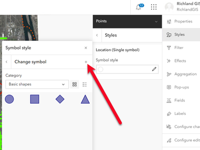

Once the style is in the Org, I opened map in map viewer, highlighted the layer, select "Styles":
Click on the Symbol style, then the Basic point (or whatever comes up) arrow, then click on the + sign:
This should let you add your new style to the web map, and can then be used for symbology.
