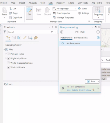

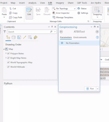

x = r"C:\Users\...\Default.gdb\Polygon"
y = r"C:\Users\...\Default.gdb\Polygon_1"
z = r"C:\Users\...\Default.gdb\PolygonClip"
arcpy.analysis.Clip(x,y,z)
HOWEVER. The same code in a PYT and an ATBX turned off the session and turned it back on.
