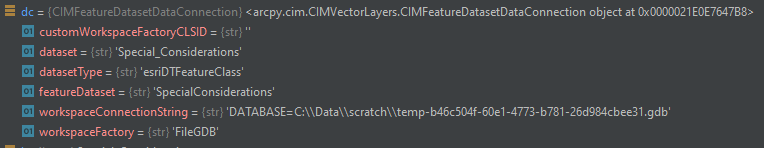

Here is the layer as it currently exists in my map:

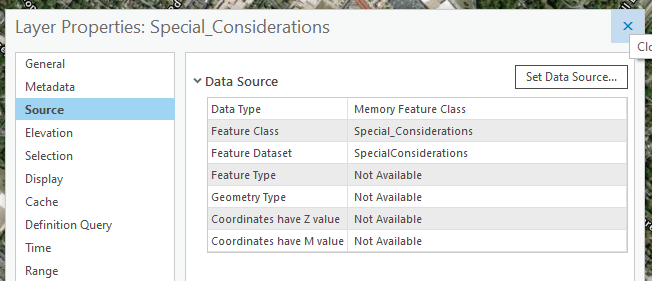

And here is what I'm trying (though I have tried a few things with no luck).
lyrCIM = l.getDefinition("V2")
dc = lyrCIM.featureTable.dataConnection
dc.workspaceFactory = "InMemoryDB"
dc.datasetType = "esriDTAny"
dc.workspaceConnectionString = r"memory//" + l.name
Edit:
Well, maybe it is working?

I am trying to use the newer `memory` workspace. Seems it has the same limitation and I missed it.
https://pro.arcgis.com/en/pro-app/latest/help/analysis/geoprocessing/basics/the-in-memory-workspace....
This was what caught my eye:
To display memory-based data in an ArcGIS Pro map, you can use the memory workspace.
