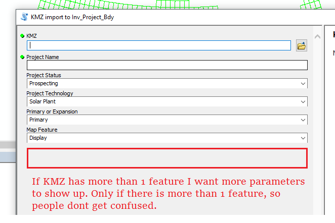

So I would need to edit the code in the Validation tab?
see image.

Adam Arcichowski‌ yes that is correct.

Now that I think of it, I'm not sure if this will work because the  "arcpy.GetCount_management" will not work on a kmz correct?
If I select a kmz with multiple features in it, can the Validation script run to convert the kmz to a feature layer than use the GetCount function and then have the other parameters come up ?

It can, but you may want to be careful with this approach.  From the help:
Called each time the user changes a parameter on the tool dialog box. After returning from updateParameters, geoprocessing calls its internal validation routine.
You will want to make sure the tool is not running the KMZ conversion after each parameter is updated.
