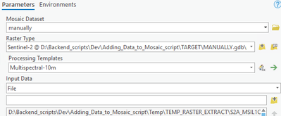

I am trying to execute the "Add Raster to Mosaic Dataset" tool using arcpy.
but while using arcpy we don't get the option to add the processing template. No parameter is available in the arcpy function to add raster to mosaic dataset.
I want to select the "Multispectral-10m" template as I am only interested in 10m .

RonitJadhav
Sorry, I still did not get how can I use processing template by using the Input path parameter.
The above is what I am trying to execute from arcpy.
but I am not able to select the Processing Templates: Multispectral-10m from arcpy function.
