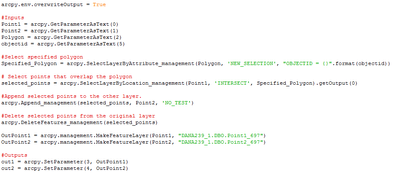

One last question, I want to specify a specific feature in the polygon layer by specifying the objectid value, I tried to do the following script, again, it works in ArcGIS Pro but it doesn't in WAB. Do you have an idea what could be the issue?
Luke_Pinner
MVP Regular Contributor
Specified_Polygon is a Result object not a FeatureLayer. Use Specified_Polygon = arcpy.SelectLayerByAttribute_management(etc...)[0] or arcpy.SelectLayerByAttribute_management(etc...).getOutput(0)
DanaNajeeb
Oh, I get it now. Thank you very much!
