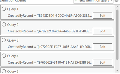

Been using 2.8 for a bit and have had no problem clearing definition queries with the following code.  If TurnQueryOn is true it sets the definition query. If it is false it sets definition query to None.
 if TurnQueryOn:
                RecordWhereClause = "CreatedByRecord = " + "'" + RecordNumber + "'"
                for FilterLayer in FilterLayers:
                    mapFilterLyr = Map.listLayers(FilterLayer)[0]
                    if mapFilterLyr.isFeatureLayer:
                        mapFilterLyr.definitionQuery = RecordWhereClause
            else:
                        mapFilterLyr.definitionQuery = None

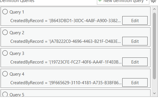

I just upgraded to 2.9 (I still have a machine 2.83 so was able to double check).  But the definition queries are no longer being deleted but just turns them to "inactive".
Is there something I am doing wrong?  (I have seen other posts for this in the past and they appear to operate the same as mine does in 2.83.)

Sorry found some code elsewhere.  The following will remove all definition queries from a layer.  In this case the layer is called "Anno0200Scale" as follows:
import arcpy
aprx = arcpy.mp.ArcGISProject("CURRENT")
Map = aprx.activeMap
Lyr = Map.listLayers("Anno0200Scale")[0]
Lyr_cim = Lyr.getDefinition('V2')
fTab = Lyr_cim.featureTable
fTab.definitionFilterChoices = None
Lyr.setDefinition(Lyr_cim)
I am not sure if this is the best way to do it but it does it.  Please let me know if there are better ways.
