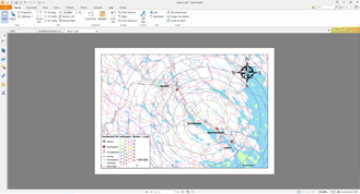

I have made an map where I can see respone times for the fire truck, I did it in service area of network analysis, and made one for helicopter with buffer tool. In the attribute table have i add field like minutes, speed and distance.
My problem now is how I should do to merge this to layer to one where I can see if the helicopter or the fire truck is fastest to each pixel. I want it in a layer there it shows in two diffrent color.
Or is there another way I should have done the last maps to create this map.
Hope someone understands what I mean and can help me
/ Lina

Do you have two data frames? one with the desired service area and one without?  If so, simply move or copy the layer into the desired dataframe.  Or perform the analysis in the right data frame.  If is confusing since you are showing layouts and it is the contents of the data frames that is of more importance

There are two maps created in the same file, but consists of two different layers. If I make these to raster with polygon to raster tool so I can see in each of these two layers how long time it takes to travel to each specific pixel. Now I'll need to create one commonly layer of these two which shows in each pixel if the fire truck or helicopter is the fastest. I can Not have this layer on top of each in the table of contents. I guess I can use the tool, raster calculator? but do not know what formula to write to get it to appear like this. I think something like if the fire engine is the fastest so, 0 , if helikoterns is fastest so 1. So I can in this new layer see only in these two colors, which is fastest to each specific pixel.
Here is the raster layers, that I want to in only one layer and show the fastest. Each color is for every 2 minutes up to 30 minutes. They are in the same cell size.
