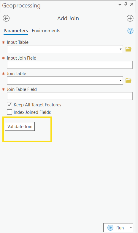

I was wondering if there is a way to add a button to a geoprocessing tool to validate and have a pop-up message before the user runs the tool.
For example, the Add Join tool has a button like this.  I couldn't find a way to add a button though and am wondering if I am missing something.  Thanks!

you can validate a tool
Customizing script tool behavior—ArcGIS Pro | Documentation
you can get a checkbox but not a button if have optional parameters

Here's a simple example tool that should work using @DanPatterson 's checkbox button idea. I use checkbox buttons this way all the time:

BittersDaniel
Thanks for that example, I might try to implement something like that.
One scenario I am concerned about is if a user starts checking and unchecking the box within seconds, which would probably interrupt any geoprocessing functions that need to happen in the validation and could confuse the tool.
