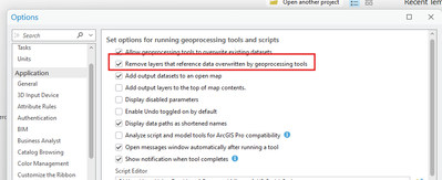

I think this is default behaviour, you can alter the behaviour of tools through the options dialog, try unticking this option to see if this creates the behaviour you are after?
2Quiker
I will have to try unchecking the feature. Thanks!
