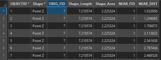

I then tried an arcpy Select By Attribute command to select the point with the lowest distance for every group of points (points that sit on the edge of the same shape share a common original FID, field as seen in the attribute table):
The SQL expression looked like this, using the select by attribute tool.
NEAR_DIST = (SELECT MIN(NEAR_DIST) FROM asset_points GROUP BY ORIG_FID)
However, that didn't return the minimum value for each of the groups; only the first group in the point file attribute table.

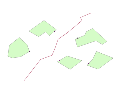

Does anybody have any ideas about how I can achieve this, and then slot it into my python script? Here is what my desired output might look like:

You can also calculate a new field that tells you if a point is the closest point:
shapes_points = arcpy.management.GeneratePointsAlongLines("shapes_lyr", "memory/shapes_points", 'PERCENTAGE', Percentage=7)
arcpy.analysis.Near(shapes_points, road)
arcade_expression = """
var fs_points = FeatureSetByName($datastore, "shapes_points", ["ORIG_FID", "NEAR_DIST"], false)
var fid = $feature.ORIG_FID
fs_points = Filter(fs_points, "ORIG_FID = @fid")
return $feature.NEAR_DIST == Min(fs_points, "NEAR_DIST")
arcpy.management.CalculateField(shapes_points, "IsNearest", arcade_expression, "ARCADE", field_type="Short")
with arcpy.da.UpdateCursor("shapes_points", ["IsNearest"], "IsNearest = 0") as cursor:
    for row in cursor:
        cursor.deleteRow()
arcpy.management.DeleteField(shapes_points, "IsNearest")
