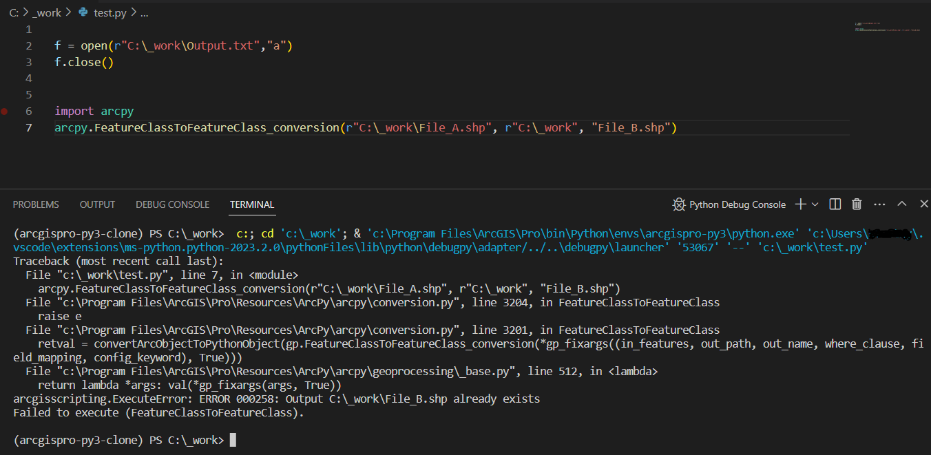

files are not written to disk at all. For example:
f = open(r"C:\_work\Output.txt","a")
f.close()
import arcpy
arcpy.FeatureClassToFeatureClass_conversion(r"C:\_work\File_A.shp", r"C:\_work", "File_B.shp")
After running this realy simple code, I don’t get any errors or warnings. But neither file Output.txt nor file File_B.shp cannot be found in C:\_work folder
When I run this line of code again:
I'm getting his message:
arcpy.FeatureClassToFeatureClass_conversion(r"C:\_work\File_A.shp", r"C:\_work", "File_B.shp") arcgisscripting.ExecuteError: ERROR 000258: Output C:\_work\File_B.shp already exists Failed to execute (FeatureClassToFeatureClass). 
But there is no file File_B.shp in my folder C:\_work

Since the command says the file exists my guess is the files are really there and that you need to refresh whatever tool you are using to see them.
What does this tell you? True or False?
import os
os.path.exists(r"C:\_work\Output.txt")
or
arcpy.Exists(r"C:\_work\File_B.shp")
Hope this helps
