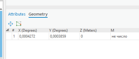

How add correct coordinates to map in wgs 1984?
1482
04-16-2021 11:58 PM
Radzhabad
xy = (47.550976, 42.963041)
array = arcpy.Array()
with arcpy.da.InsertCursor(schetchiki_path,['SHAPE@XY', 'Name']) as c:
    c.insertRow([xy,name])
d9yQZ
