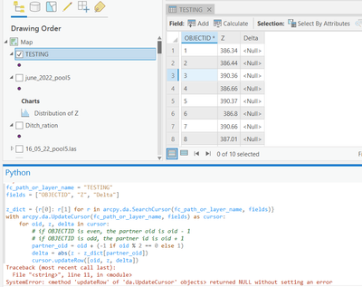

hello , i have 8 points with Z value .
each 2 points is a pair ( see the colors in the image attached).
i created a new feild calles "Delta" that in their i want the result of the difference between a pair..
for example the difference between point 2 to 1 is 4.66 meters..
 is there a way to do this via while or for loop ?
thanks for the help!

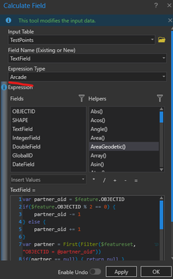

Try a different approach:
Calculate the field, switch language to Arcade, use the script below. Be sure to clear selections!

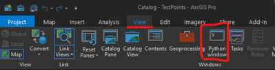

Open the Python window:
Copy the script below, paste it into the Python window, edit the first line, run it

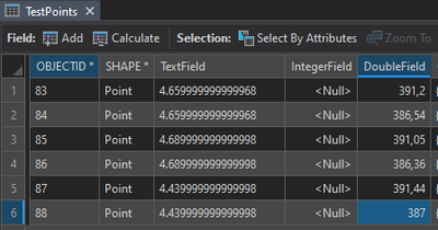

Here, I used DoubleField as Z and TextField as Delta:
!!! The script assumes that your screenshot shows exactly what your table looks like, especially that the pairs are always odd and even ObjectID. If this isn't the case, the script gets a little more complicated (but not much) !!!

matu89
hey ,
thanks for your response.
i tried to run the script, but it wont run..
here is the messege :
what went wrong?
thanks!

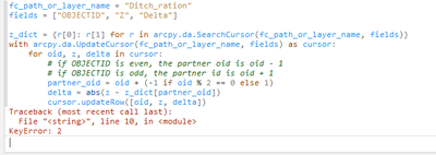

JohannesLindner
MVP Alum
It couldn't find OBJECTID 2.
Clear all selections and try again. If it still doesn't work, you need the slightly more complicated script.

matu89
this time i get the following mmessege :
JohannesLindner
MVP Alum
I hate that error so much... And it could have any number of reasons.
var partner_oid = $feature.OBJECTID
if($feature.OBJECTID % 2 == 0) {
    partner_oid -= 1
} else {
    partner_oid += 1
var partner = First(Filter($featureset, "OBJECTID = @partner_oid"))
if(partner == null) { return null }
return Abs(partner.Z - $feature.Z)
Have a great day!
Johannes
matu89
that worked well!
thank you so much!
