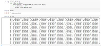

HadiK
Thank you so much for your response,
Seems it worked. Good. But I'm not able to apply it or display the new data?1
When I print field it shows me 'lon'
When I print fields it shows me the whole fields name only.
Am I doing something wrong here?! Cause I did exactly as you said 
