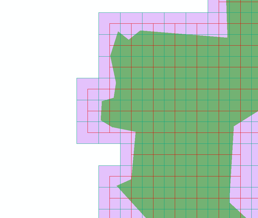

In an effort to create a series of simplified polygons for large national complicated datasets, I am using the arcpy.GridIndexFeatures_cartography function for this:
I take a feature class, use the XMin and YMin values to define the origin point of my analysis. I then subtract an adequate value (~500 meters or so), and use that point as my origo point.
I first create a GridIndexFeature (the red squares) over my input feature class (green polygon). I then offset the origin point with half of the width of my grid and run GridIndexFeatures again on the previous result. I can then dissolve this for a rough, low vertex count, rough bounding geometry, where I know i have atleast half a grid-size worth of buffer. This works fine in Python 2.7.

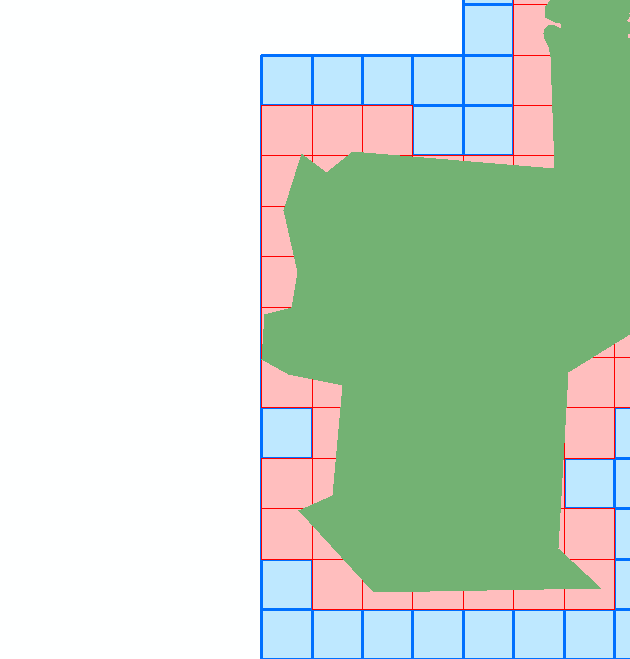

However in python 3.5, It always uses the input feature extent. I am using the exact same script. If I run the tool in ArcGIS Pro, I can enter the origin point manually and it will provide the same result as python 2.7. But not when running through arcpy in python 3.5. I guess I can just use python 2.7, but I dont know if this is a bug in arcpy?
Is there a way to enforce the origin point in arcpy.GridIndexFeatures in python 3.5?

KristianHerner
I am using all the correct variables and I am using the correct syntax. If I run my script in python 2.7, it works as expected. But in python 3.5 it ignores the origin input:
