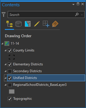

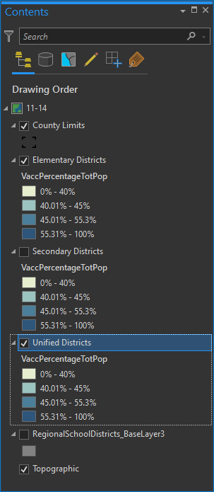

Three graduated colors layers before running script.
I change a break value from 55.3 to 56.3, and it's corresponding label. Then I run the script.

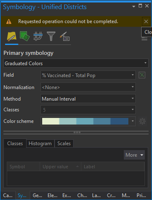

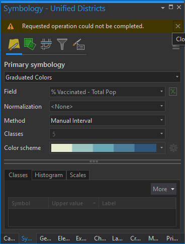

The following is what happens. I get a warning in the Symbology pane (which doesn't tell me much).
And my layers no longer have values.
